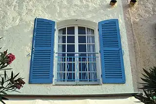

Now... ever see the pretty decorative shutters on certain styles of house? They're not real, they don't do anything.
enter image description here src
However, they are a stylistic mimicry of real shutters, whose purpose is what you want.
Although, looking closer at my chosen photo, I see a pocket in the windowframe and obvious linkage equipment on the shutter proper -- this may indeed be a functioning shutter. These can close in seconds, and the tenant can do it, assuming they can access whatever mechanism holds them open.

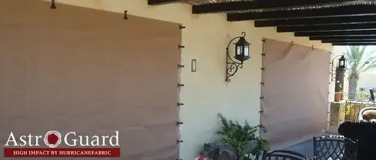

Getting along in years means not as much flexibility or strength when it comes to installing hurricane protection. Sheets of plywood screwed or bolted in place doesn't work any more. Storage is a pain too.
Hurricane fabric is a development that we've embraced and recently installed. The preparation involves drilling and mounting studs around the area to be protected, and those remain as minor eyesores. The fabric is cut to match the opening and gussets are bolted to the fabric.
The stuff appears to be a heavy duty fiberglass type cloth, much more durable than, but resembling trampoline fabric in a yellowish color. It's heavy duty and not too heavy to handle easily. It folds away in seconds and mounts in a matter of minutes per opening.
If one does not spring for the permanent stuff, this seems to be a good option.
hurricanefabric.com
An upside to this stuff is that it passes some light, allowing the panels to remain in place without the interior feeling like a tomb.
Florida hurricane regulations are somewhat severe, not that other locations are lax and these panels pass those guidelines.
