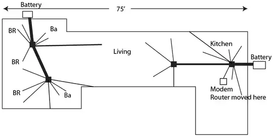

Example:
This is just a quickie to convey the idea, much more could be done with it. This is with a long, narrow house with all the action on the ends, so 2 separate LV systems. Trying to run a fat trunkline down that long middle didn't make any sense, nor did running 15 "smaller" wires. There is some fat wire between the distribution points and battery. A choice was made to move the cable modem and router to the utility room to be near the battery, instead of wasting time trying to haul power to its difficult location in the living room. Easier to move phone and Internet lines. Since branches were kept short, #12 and #14 wire could be used, except for the bedroom-living room run for its lighting. There's only 40' of fat feeder and 20' of smaller feeder.

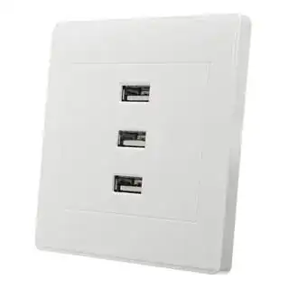

all I really need is a USB socket in a wall
Well, you can get those. USB-only sockets and combination 120V/USB sockets exist. These have an adapter built in.
USB socket USB socket 2
