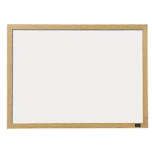

I would like to convert my walls (at least one of them)
into a laminated surface so I would be able to write things on it.
Because the wall is massive, and I do need a massive space to write on,
I'm not sure what kind of a solution there is in order to laminate/coat it
with a thin layer of writable material (as in, easy to erase and re-write over and over again).
To clarify, I basically want to convert my wall to this
without finding a huge board.
