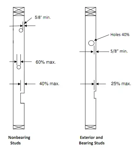

Building codes dictate how large the holes and notches can be.
International Residential Code (IRC)
Any stud may be bored or drilled, provided that diameter of the resulting hole is no more than 60% of the stud width and the edge of the hole is no more than 5/8” to the edge of the stud, and the hole is not located in the same area as a cut or notch. Studs located in exterior walls or bearing partitions drilled over 40% and up to 60% shall also be doubled with no more than 2 successive doubled studs bored.
Which means for bearing walls with 2x4 studs, the maximum hole diameter is 1 3/8" and maximum notch depth is 7/8". For a non-bearing wall with 2x4 studs, the maximum hole diameter is 2 1/8" and maximum notch depth is 1 3/8". For bearing walls with 2x6 studs, the maximum hole diameter is 2 3/16" maximum notch depth is 1 3/8". For non-bearing walls with 2x6 studs, the maximum hole diameter is 3 5/16" maximum notch depth is 2 3/16".
