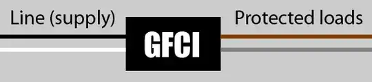

GFCI+receptacle devices are very confusing because they are doing two things. Let's break it up.
What is a GFCI?
A GFCI is a black-box which inputs hot(s) and neutral on its "line" side ... and then it outputs protected hot and neutral on its "load" side.
That's it. To signify the protected side, I use brown and gray wire in conduit work, but you can do the same by tagging wires with brown and gray electrical tape. It can be a circuit breaker, or a dedicated black box. If that's hard to visualize, look at this.
This is a GFCI device in its purest form: a "deadface" GFCI. You can only hook this up just like the diagram: supply wires to LINE and downline load(s) to LOAD (otherwise what's the point?)
Since you have first location and supply wires identified, do exactly that. Pigtail the loads if necessary, though some GFCIs use screw-and-clamp to allow 2 wires on a screw.
Be prepared to install a box extension if the box is too small to fit the GFCI device and the wires.

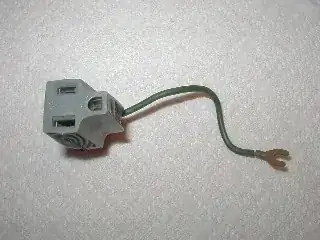

Now, this external tester will not work if the receptacle is not actually grounded. (there is no way to induce a ground fault without a ground). In that case, get a 3/2 prong "cheater" and extend the ground wire/tab with other wires, to reach a place with an actual ground. Plug the tester into that and it should work/trip.
Once it passes, also put a "No Equipment Ground" sticker there.
