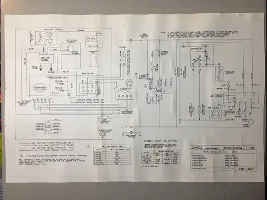

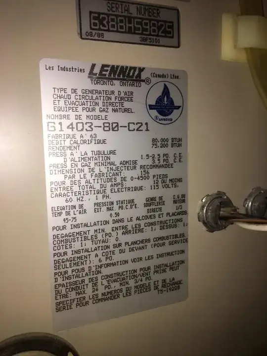

Edit, added model and diagram pictures: enter image description here

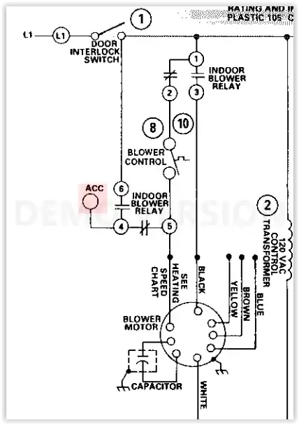

EDIT 2: I realized that ACC isn't actually connected to anything. It gets 120VAC when I switch the relay, but there is still no path to the blower to be energized. Could I just take one of the speed wires from the blower motor and connect it to ACC so that it acts as an indoor blower? enter image description here

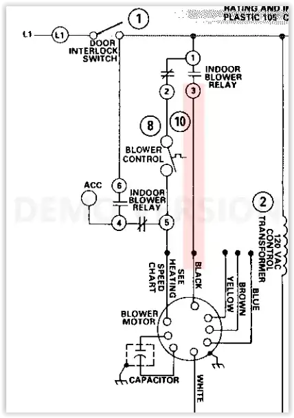

Alright, I figured out why it wasn't working. Had nothing to do with ACC not having a lead. I was looking at my setup closely and noticed that only 2 wires were coming up from the motor, but it needs 3. I noticed that there was a wire coming from pin 3, but it was crimped and didn't run to the motor. So I looked at the speed table and decided I wanted to run the Brown wire up. Connected it to pin 3. Now when I short R and G, the fan turns on :) enter image description here
