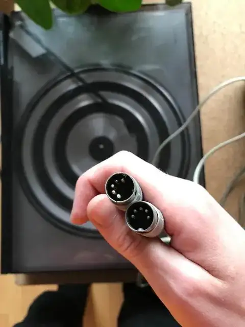

I have this old Bang & Olufsen vinyl record player, with a old connector for the speakers. Do anyone know what type of connector this is? And if there exist some converters?
Looks like DMX, but it can't be that?
Would love to get this to work again.
Pair of 5-pin DIN connectors

Those are 5-pin male DIN connectors. Same as used in the original IBM-PC keyboard cables.
From the photo this is obviously a patch cable of some kind for an audio application.

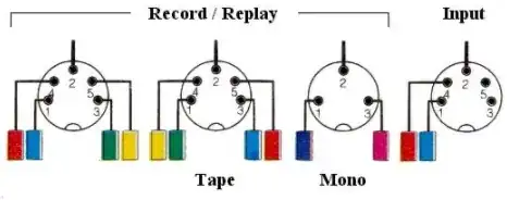

Here are some typical wiring schemes:
(Shields are connected to pin 2)
5 pin Male cord Mt. 180 degree, Din Connector (Amazon)

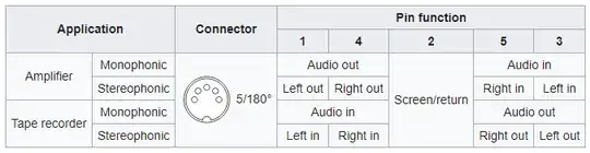

This is common on old audio equipment in Europe:
https://en.wikipedia.org/wiki/DIN_connector#Analog_audio
Though your equipment could be wired differently, so it's worth checking carefully with a multimeter to avoid possible damage.
It's unlikely that the record player had an amplifier, so it wasn't meant to connect directly to speakers. You've use this cable to connect to an amplifier, then attach the amplifier to speakers.
It's a common enough problem, though, that if you search for "Bang & Olufsen 5-pin DIN to rca" you'll find cables you can buy that convert it to the more common RCA audio connectors you'll find on amplifiers today.
