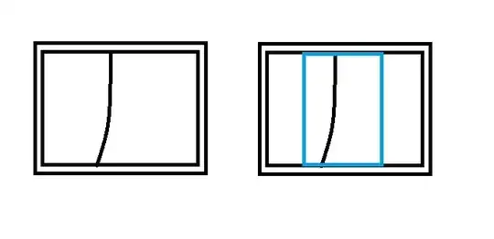

To build on @dbracey's answer, I think a good repair option at this point is to cover the crack with a new peice of wood on both the interior and exterior sides of the door. The width should be sufficient to center the piece and cover the crack. The thickness needs to take account for the trim surrounding the panel so that is is flush with the existing trim. Attach with Gorilla glue, let dry and then countersink wood screws to secure the interior and exterior pieces together. Fill in the screw depression, sand prime and paint. With all the thickness, a short screw (maybe a 1/2" at most) would be required taking account the 2 new pieces and the existing door panel to secure the three pieces together. Just glue might work also if the glue is water and temp resistent (outdoor side).
I've included a small diagram of a potential mock layout, the blue would be the new piece of wood. This would be the inside, just repeat the same for the outside.
Door Crack Diagram
Another option would be to replace the door entirely.
