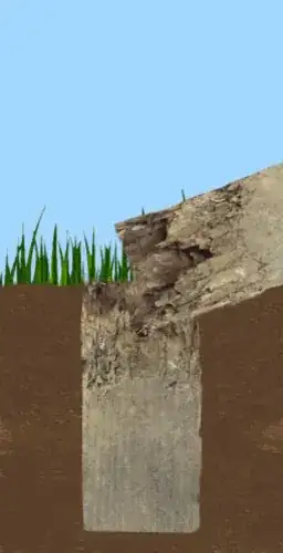

The most common failure with posts in concrete is "collar rot", where the post rots right at the point where it exits the concrete at the ground line. This can be easily avoided if the concrete is slightly above ground grade and domed or tapered away from the post so water doesn't lay against the wood. Drainage is the key, keep standing water away from the posts and they will last a lot longer.

Shirlock's answer is absolutely correct. Fence posts rot where the post exits the soil. One square ft. of soil contains millions of microbes. The soil builds up around the base of the post and acts like a sponge to retain moisture. The moisture and soil is fuel for fungi and the oxygen fuels the rot. Rot needs four elements to spread. Rot can not start underground as some people believe. There is no oxygen. That is why when you pull out an old fence post the rot only goes a couple of inches below the grade or where the post exists the concrete, the bottom of the post is solid. Yes fence posts rot well before the fence boards.

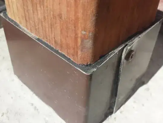

Crowning the concrete, or bringing the concrete above the grade and sloping it away from the post is a great way to keep the soil away and rotting the post, however soil can still build up above where the concrete is crowned and concrete holds moisture also like a sponge. One problem is the wood swells when it get wet and will crack the concrete creating a gap between the post and concrete, creating a pool where water drains into the gap. There is a product called The Post Collar that we use to protect the base of the post where it exits the concrete. Also one nick from a weed-eater and a pressure treated post is now nothing more than Fir. The Post Collar protects from garden equipment. It also has a materiel that acts like a buffer between the post and concrete to eliminate the cracking I wrote of above. The Post Collar has an inner mastic material that is both fungi proof but you can nail into it and the nails self seals, the outer shell is coated galvanized steel. I have been using it for a couple years now. I am a fence contractor and we have now increased our warranty to 20 years on all posts using the Collar. I suppose one could be made using the same mechanics but they are very inexpensive. They also work in preventing cracking in concrete in freezing climates. I use this product and recommend it daily but do not own any part of the company that makes them. It is just the answer to collar rot.
The Post CollarCollar RotSelf Sealing Butyl material.

Solution: I use a product called ROTBLOC I found at Home Depot and Lowe's. For a cost between $3-5 it protects the post slightly above and below the ground line. No added adhesives or materials required. All you do is wrap it and tack it on. It has a warranty but I have not had to replace my posts in over 12 years.
