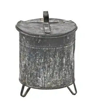

An Oily Rags Bucket is not just a metal bucket with a lid, nor is it sealed, ever (explosions are worse than a fire). It is a specially designed container incapable of being left open while it remains upright. The top handle keeps it from opening past a 45 degree angle; self closing.
The means of disposal may differ, however the safe storage of oily rags requires the proper container.
