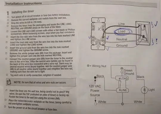

Based on this answer and this answer, it looks like I got a wrong switch. However, my switch comes with an extra jumper wire to hook up to the neutral line.
  • Based on my previous setup, are the wires in my wall hot and load, or hot and neutral?
  • Can I use the jumper wire to connect either line or load to the neutral terminal, to get the timer to work?
I attached photo of the manual. The drawing of the socket shows wires coming from both top and bottom of the socket (line and neutral from one end, load and neutral from another end), but I have only two wires coming from one side.

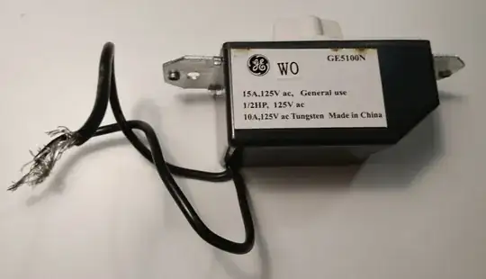

Old timer switch old timer switch
Manual. Circled connection is missing. I stopped at the third-last step (Remove the white jumper wire) photo of manual

A spring wound timer switch, like the GE unit you're taking out, is you-powered. It doesn't need energy from another source to do what it does. Like any passive switch, it is simply a gate between "always-hot" and "switched-hot".
However, your push button timer switch needs power to do its little thing. And it needs power at all times. In electricity, you get power between hot and neutral.
So the switch needs neutral. Your switch is on a switch loop, and historically they never provided neutral on switch loops. Now they're starting to do it... but if you don't have neutral, you can't use this switch.
