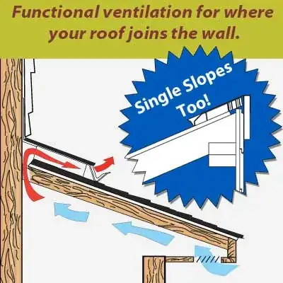

If the exhaust net free area is too small, then you can add a shingle over ridge vent. If you have a hip roof and don't have much horizontal ridge lines, you can also use hip vent. Alternative solutions for adding exhaust vents is with Omni-Wall vent for where the roof meets the wall and you can't put a regular vent. Adding regular roof louvers is the obvious option, but like I said earlier, exhaust is rarely the problem with ice dams.

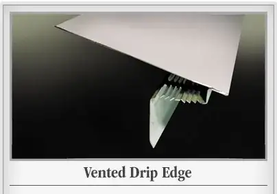

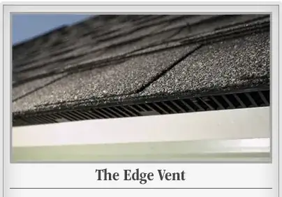

Alternative solutions for adding intake vents in places other than at the soffit are vented drip edge and shingle-over edge vent. Either of these options should work.
Omni-Wall vent Vented drip edge Shingle-over edge vent
