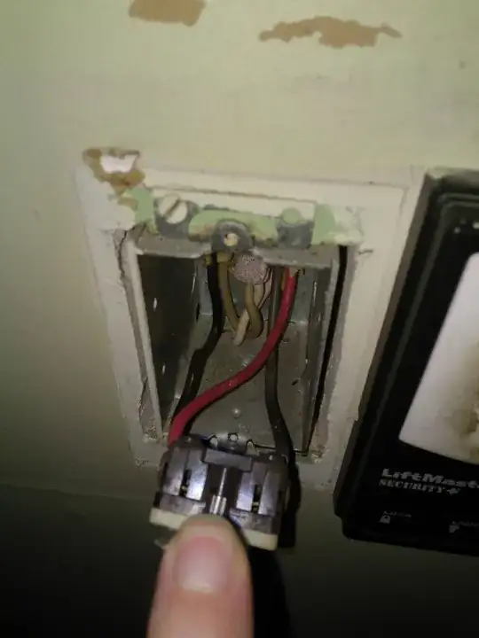

Here is the box where I am trying to put the indicator LED:
Indicator Box

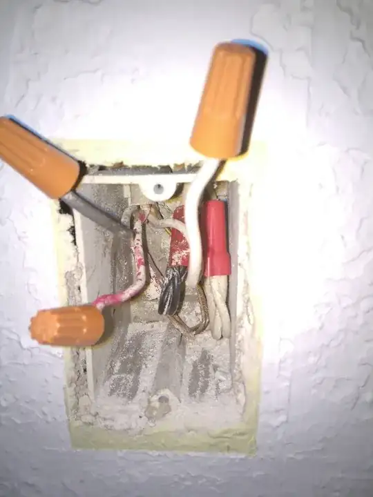

Here is the switch in the garage closest to the interior of the home and subsequently the indictor box above:
Close Switch

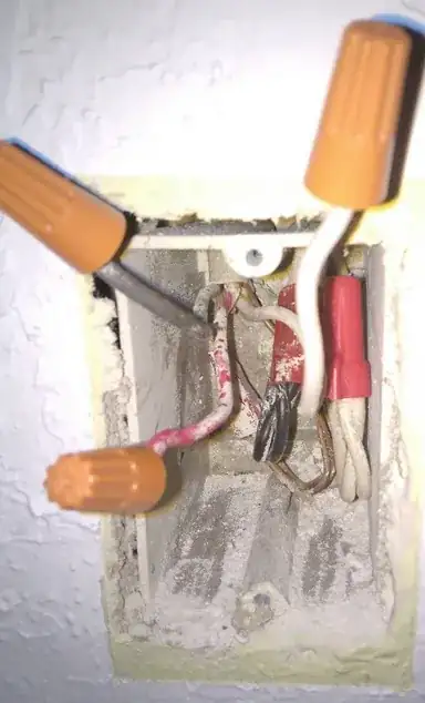

Here is the switch on far side of garage and subsequently closer to the breaker box:
Far Switch

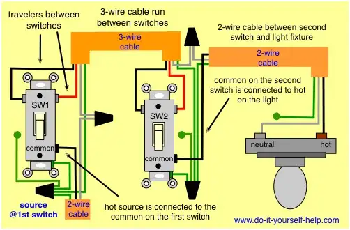

Three way Wiring For a Light - Switches First
EDIT 11/14/2017 The light I assume was already in the circuit and had two wires to it. Your hot and neutral that go out to the light in the garage is what the LED would connect to just like the diagram above (parallel); try hot on one lead neutral on the other swap the wires around if it does not work. The previous owner might have wired it in series with your garage light- this approach may not work properly with an LED which is a Diode (that emits light) and passes DC only, thereby reducing the voltage to the garage lamp because you only have half the wave of the AC.

Now when you know which one is the lamp - you should have black and red as hot in any on position - so in your wiring that goes to the indicator - just leave the red wire nutted off on both ends. Connect your indicator jackets black lead (going to the indicator) to the common of switch 2 (per diagram below I have updated) and the white lead connect it to the neutral (at this point it should work) - so reconnect switch #1 according to your picture you sent the way it was originally (black on left and red on right). I usually take pictures for projects - because interruptions - I will forget how it was and I am too lazy to draw or write it down.

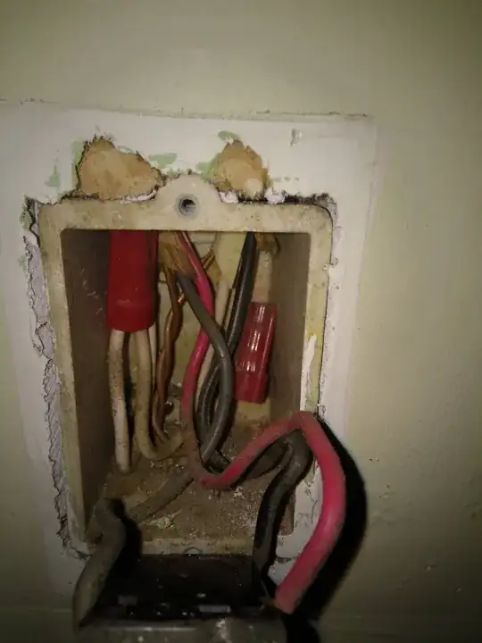

As I am looking at the three pictures I find the one that is bothering me the most is the indicator connection. I see a R,B,W,C wire set (which means it has to come from either outside of this circuit (switch 1 and switch 2) or it is 'spliced' / wire nutted in somewhere along the path of the traveler wire set (R,B,W,C) from switch 1 and switch 2. and you said when switches on that white was hot too (wrong thing by code).
Indicator Box
TO MAKE IT WORK
So if all are hot when switches are on - to make it work you can pick that wire nutted white wire (with the pretty red wire nut) back of box on the right hand side where the 2 two line sets are nutted together (verify that it is a neutral measure between it and the Red or Black of the (R,B,W,C) wire set; If you read 120V use that for one lead to your LED and then use the Black from the (R,B,W,C) wire set for the other - it should work.
That said I would not say the wiring is correct as the (R,B,W,C) set in the indicator box - where does it come from and how is it connected ?

Total rewrite to take a swing at this Gordian knot. It's not fully solvable with the information we have. For instance, at least one end of a /3 is unaccounted for.
But from comments above, we know OP has the 3-way circuit in the garage working. The only loose end is the indicator light.
Process of elimination. The two 3-ways in the garage only have 2 cables coming into them - one /3 and one /2. The /3 must necessarily include the 2 travelers (red and black here). This is a bone-stock 3-way setup, and can only possibly be that. This accounts for all the wires in those two boxes.
Now we have a third box. It has two /2 cables that are thru-nutted to each other and pushed into the back of the box. Those probably don't have anyhing to do with the garage light but is just power passing through, possibly with an eye toward future expansion. Then you have another (!) /3 cable, and since only it was disturbed, the garage indicator light must be powered by it. That's weird. /3 is expensive cable and not used lightly. Perhaps it was part of a former 3-way circuit which was since re-tasked for this purpose.
We know the indicator is not in series with the garage light because the garage light works with these wires loose. We also onow a non-series indicator lamp needs 2 wires: neutral (to return current to source) and switched-hot (to power the indicator only when the garage light is on). And it worked before, so those wires must be there. The question is, which 2 of the 3? (And idly, what does the third do?)
The way to find out is testing. You need to put a tester of some kind on any 2 of the wires, while turning the garage light on and off. Repeat until you find the right result.
