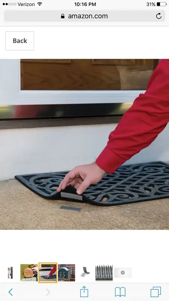

Velcro strips of high strength variety work well enter image description here
