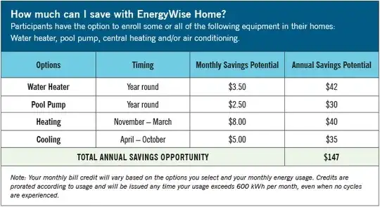

It must be for electric appliances only? It sounds like the biggest pitfall is having no energy when you want it... A one-time $150 credit sounds like a terrible deal. Even $150 every year is small change compared to most yearly utility bills, and the annoyance this could cause.

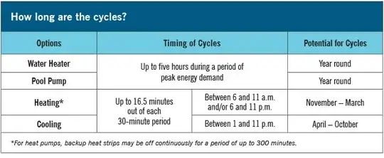

Here's their image of when you could get your power "cycled" off. Approximately 45% of your possible heat anywhere from 6AM to 11AM, and 6PM to 11PM, and 45% of your possible cooling from 1PM to 11PM. Basically anytime most people are at home and awake:
You might not even get any credits either, it says "To earn credits, customers must meet minimum energy requirements. Customers with lower energy usage may not qualify." I don't see the minimum energy requirements specified anywhere, other than the "exceeding 600KWh/month you'll get credits even with no cycles" below.

When EnergyWise Home cycles my heating or air conditioning unit for 16.5 minutes out of 30 minutes, my unit should run the balance of 13.5 minutes. Is that correct?
Yes. However, there may be exceptions. Electronic thermostats and time delays built into your system can extend the off time, even if the power is back on.
So you'll only have heat/AC for 13.5 x 2 = 27 minutes an hour at the absolute maximum. So about 45% "power" of what you could have. For an extremely cold/hot day it would take twice as long to heat/cool, or you'll just stay colder/hotter than you like.

This sounds excruciatingly annoying, I'd rather pay $150 than fiddle with changing a timer 4+ times a year and checking/adjusting it's clock every month.
Maybe if you've got mainly gas appliances (furnace / pool heater / water heater) then just one being forced off sometimes might not affect you much at all, a pool would probably take the longest to cool down & notice. But then you won't get the full credits anyway.
If you never notice hot vs warm water & air, and meet their "minimum energy [usage] requirements" then maybe it's for you. I'd say switching to gas might be a better idea, depending on your local electricity vs gas prices. Or even propane & your own tank if that's possible.
