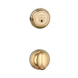

Option A: Alarm system.
Option B: Deadbolt with a captive key feature. The interior knob can be removed turning it into a double cylinder lock. Check with your local codes to see if this is permitted.

The best type of lock for that situation would be to get a double sided deadbolt. So if someone where to break the window they would be able to unlock the door, they would still need a key from the inside.
