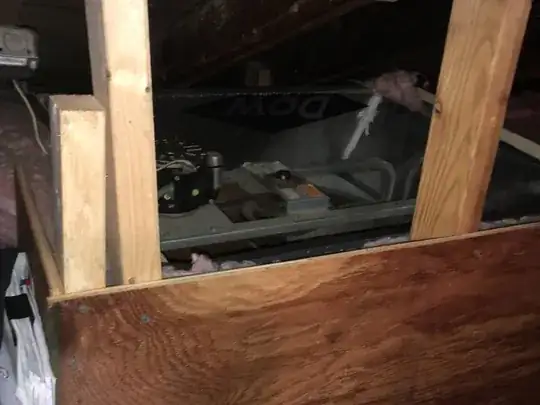

There is a 3'x3' opening in the ceiling of my second (top) floor. The opening leads into the unheated attic. I want to both seal and insulate this opening to keep out the cold in the winter. (I live in New York, were it can get cold.) I already have built a box around the fan in the attic using hard pink insulation, But it does not seal perfectly and is not all that well insulated.

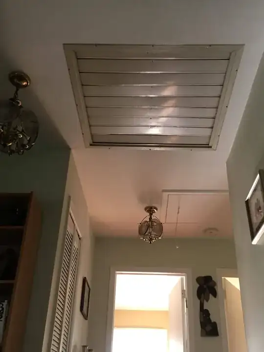

Here are photos of the vent opening and fan.

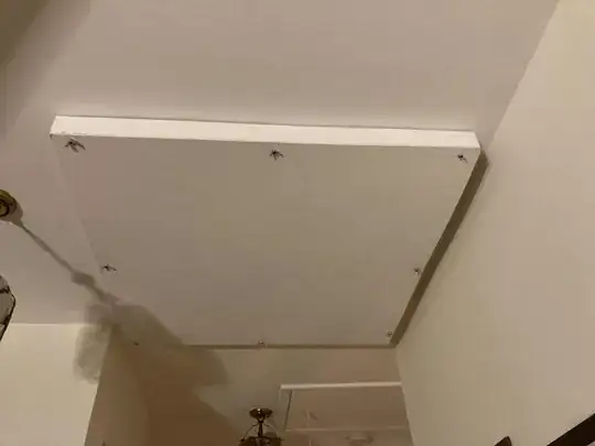

UPDATE: I did something like the answer below. I built a square using 1x2's on top of a 1/4" 3' square plywood sheet, and filled it with rigid pink foam. I put soft foam tape on the edges of the 1x2's. In the ceiling I put the wood end of Wood to Metal Double Ended Screws. I attach the box to the ceiling with wing nuts. (See phooo.)

I know this is old but, might help someone?? It looks like there are twelve screws holding up the louvered flap register. I would build the box and use four of those holes (one on each side) to secure the insulated box. You'll need four longer screws to compensate for the added box. To make it air tight to the register line the top edges/border with foam tape. Another similar option is to cut a piece of whatever thickness plywood, paint it white and line the top with some of that rubber hardwood floor underlayment and screws it on the same way as above. Hope this helps someone.
