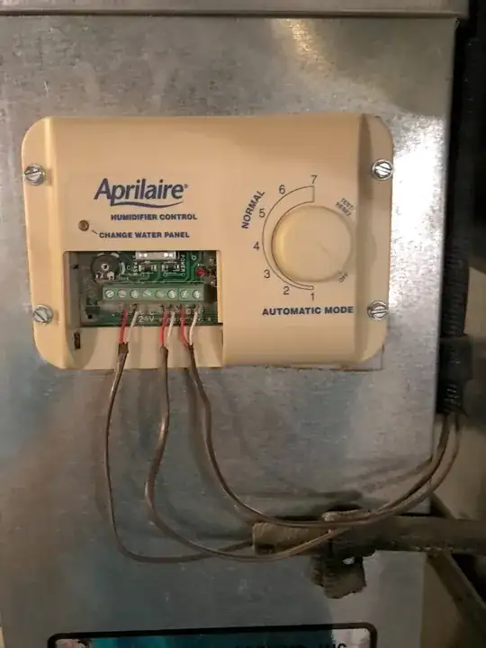

I have an Aprialaire 56 humidistat that is connected to an Aprialaire 560 humidifier. Currently the humidifier is not turning on and after testing the wiring with a multimeter, the wires going in to the humidistat are not getting a current.
This system was installed by the previous homeowner and was tested and working previously to my knowledge.

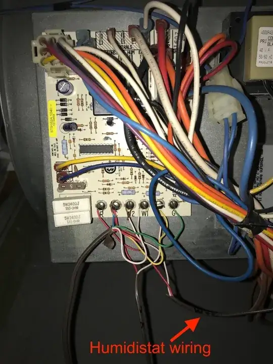

The humidistat is wired into the furnace control panel in the C and W2 terminals. From my research, W2 is "stage 2" of the furnace heating cycle. My thought is to move the wire from W2 to W1 in order to draw power to the humidistat.
Are there any other remedies to troubleshoot why the humidistat and in return the humidifier are not powering on?

Wired in this way, this should have never worked. W2 is the terminal that the thermostat uses to activate second stage heat. It is not energized by the furnace, but by the thermostat.

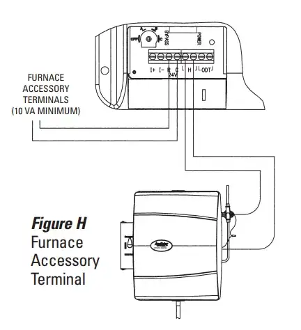

Also, it looks like the humidistat is not wired properly. The wires from the furnace should be in the R, and C terminals. It looks like they're in the I-, and R instead.
Aprilaire 56 humidistat Wiring diagram
Figure H from manufacturer's installation instructions.
