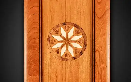

If you want to get really fancy, you could highlight the difference rather than trying to obscure it.
Fitting an inlay of contrasting wood could make the patch into artwork rather than the repair it is.
An inlay of different wood:
You would want to cut the punchhole out till its a clear and regular hole, a circle might be easiest. Then feed some backing wood in through the hole and glue it inside the void to provide support. Then from scrap timber cut a pattern to fill the hole. Finally glue it all in, sand and varnish the entire side of the door.
Or burninate the wood to show a picture and disguise the patch that way.
Images are ideas, not examples.
