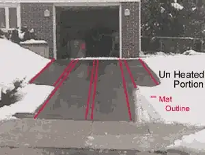

A widely available solution is to install a driveway heater to keep the crucial section unfrozen. This technique is also commonly used on walkways.
Aaron Brick
