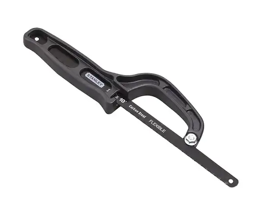

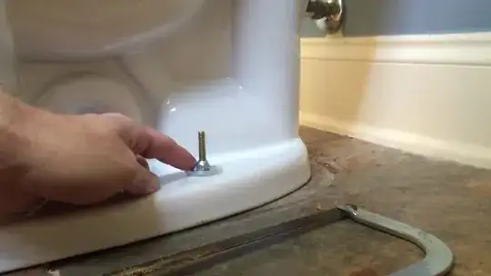

Bolt cutters are not really the best tool for cutting off rusted closet bolts. I usually use a "mini-hack" saw:

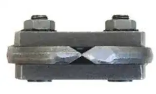

I would caution against using any bolt cutters on the toilet hold down bolts. The reason being that they typically will apply a significant pressure against the porcelain base of the stool and crack or break it.
Another thing to consider is that bolt cutters typically have a jaw profile as shown below. With this type of arrangement it is just not possible to get a grip in the small size of the bolt at or below the nut.

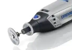

You will be far better off using a mini hand hacksaw as shown in another answer or a Dremel tool with a grinding wheel cutoff blade.

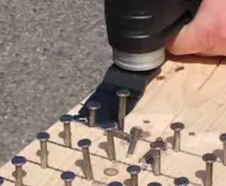

An alternative if you do not have a Dremel tool but do have an oscillating tool is to use a metal cutting blade in that. Note that it is my experience that the typical metal cutting blades for these saws do not last as long as you would hope and they are much more expensive than a few cutoff wheels for a Dremel tool.

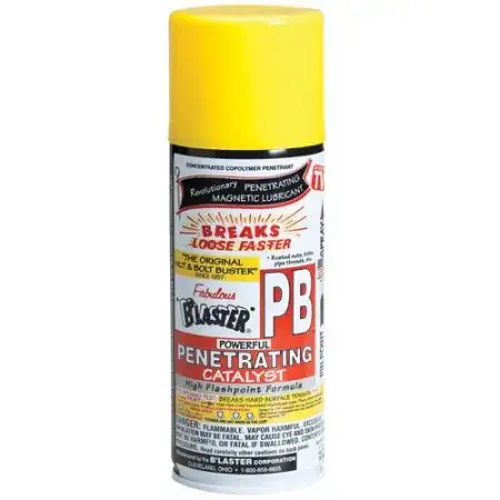

Before attempting to remove the bolts, I recommend spraying them with a product such as Penetrating Blaster.
Can of PB
Let it soak into the area around the nut for a minute or two. Next, get a socket wrench and pick the smallest socket that will fit over the nut and torque it free. If you cannot get the nut to move, try using a breaker bar which provides more leverage. If you do not have access to a breaker bar (you really should have one and they do not cost a lot), you can improvise with a box wrench and a narrow metal pipe slipped over the handle (cheater bar).
Cutting those bolts would be further down on my list of options. In order to keep the toilet firm on the floor without rocking back and forth the bolts should be moderately tight. Cutting through one of them may cause a sudden shift of weight which may cause damage such as cracking the porcelain near one of the bolt holes, or the saw blade may nick the enamel coating on the toilet. If you must use a saw, I would prefer a rotary tool such as a Dremel with the proper metal-cutting blade. Be sure to wear both gloves and safety glasses, move anything flammable away from the work area, and cover trim, drywall, anything nailed down that you do not want damaged. This will create a lot of hot sparks.

  • Dremel moto-tool, a steady hand, goggles, and plenty of cutoff discs.

My usual course of action involves using a Dremel with a cutoff wheel as @ Michael Karas has suggested. My technique involves cutting off and bolt that extends through the nut. Then cut vertically through the nut. By moving slightly from left you will cut the nut and not hit the porcelain. A thin piece of cardboard with a small hole placed over the nut may provide a little extra protection if the tool slips.

I would caution against using any kind of motorized movement tool as well (the aforementioned oscillating blade or a reciprocating saw) because the same dangers of cracking the toilet apply. A grinder or Dremel will apply steady directional pressure. Anything that moved the blade back and forth (especially on metal) may have unpredictable movements if the blade binds up.

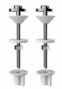

-- A bit of clarification... our toilet tanks here (France) are mounted with this kind of stuff:
The bolt head and rubber cone go into the tank, and the rest pokes out of the bottom, which results in something like that:
So the method I used was to drill the head of the bolt off. It works pretty well.
