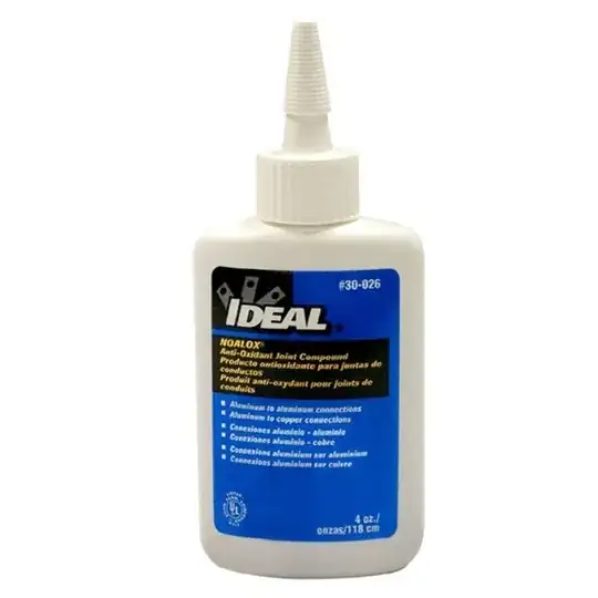

But, before you go to digging it up, it's worth going over the connections, since aluminum wire connections are tricky, and doing them right might solve your problem. You need to use a proper anti-oxidiant joint compound, and apply it correctly, then torque the connections to the correct specified torque. Obviously power needs to be OFF when doing this, so if one end of your wire is in the meterbox, you will need the utility's cooperation in getting this done, and you might want to hire an electrician anyway for the benefit of years of experience connecting aluminum wires.
Clearly the connection is showing some resistance and it is intermittent.
It would be a very good idea to call a qualified electrician to take a look at it since any resistance translates directly into heat and can be a fire hazard.
It can be a loosening connection, or perhaps water intrusion causing corrosion, or even stray critters, all of which can be easily checked.
It might very well be oxidation. Aluminum is famous for it.
It is recommended that all Aluminum connections be treated to prevent oxidation.
Here is an example of the compound that can be applied to the connection:
NOALOX 4 oz. Anti-Oxidant Compound (Home Depot $6.95)
