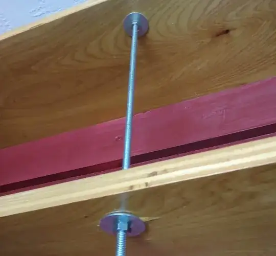

So I got "creative" with these shelves I installed. Looking for ideas to keep these nuts from loosening. I considered just gluing them in but that would make it annoying in future if adjustments are required.
Thoughts?
I know they have nuts that specifically are supposed to not loosen but that requires me taking it apart more than I'd prefer.
Thanks

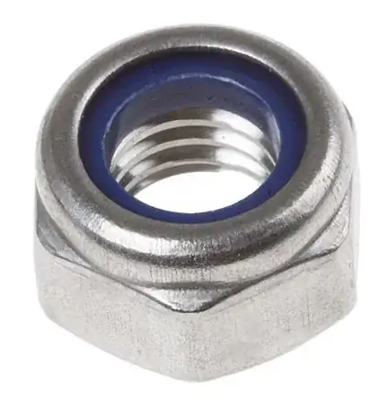

Here's a nyloc nut
http://media.rs-online.com/t_large/F0521951-01.jpg

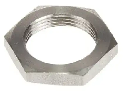

and here's a locknut - as you can see its quite thin.
https://media.rs-online.com/t_large/R7417654-01.jpg
