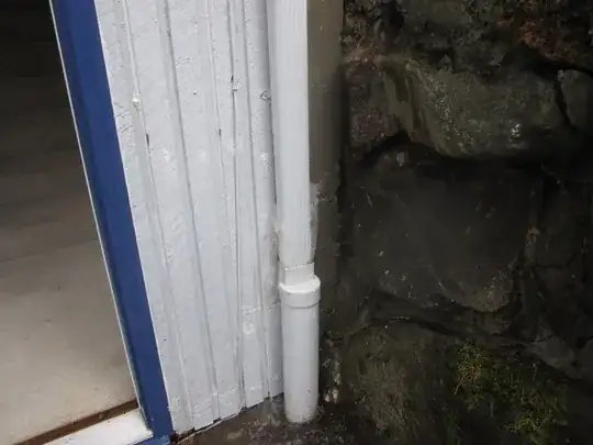

A picture is better than words...
Water shooting up from downspout
That's water shooting up from the connecting point during a heavy shower earlier due to the pressure.

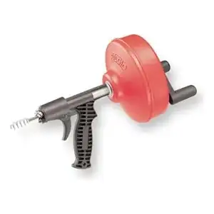

You might get lucky here and be able to clear the drain by hand, or blow the clog out using a garden hose. If not, you'll want to snake the drain out using either a handheld or drill powered drain auger.
