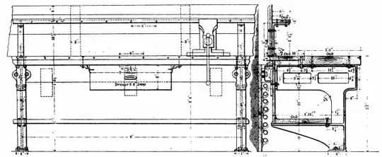

There are two different types of work benches: sitting and standing.
A sitting work bench for machine work, according to Browne & Sharpe, should be 31" high. Note that height of the chair is important and should be adjusted so the worker's knees are at a right angle when the soles of the feet are flat on the floor. Below is a design Brown & Sharpe made for work bench in a railroad shop (31" to table surface):
