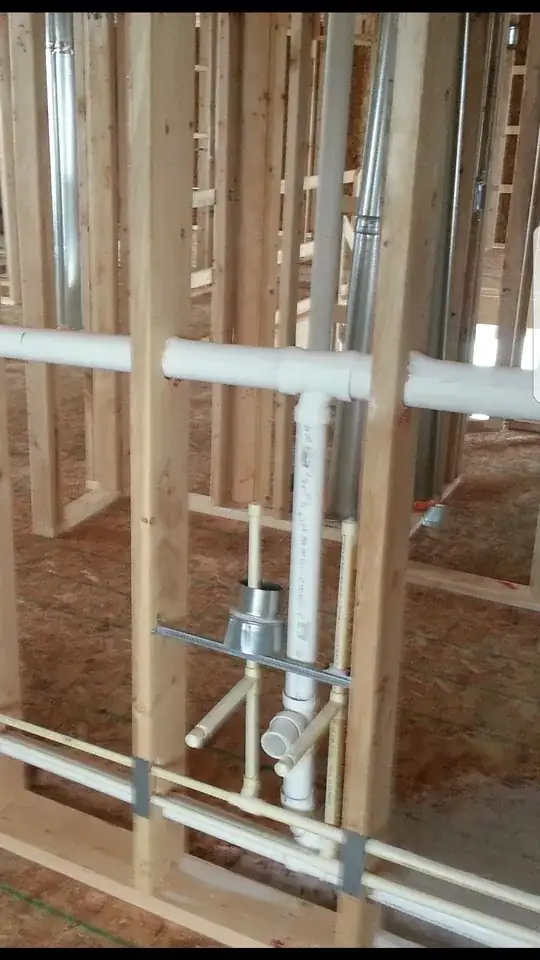

I couldn't find an answer to this question using Google. I think it's because I am not sure how to ask the question properly. I am not a plumber but I have seen in my new construction house with cpvc and I have seen in the past the same thing done with copper pipe.
When a water line comes out of a wall, just before it comes out there seems to be an area where the pipe goes up a little more and is then capped off. What is the reason for this? Why not just bend 90 degrees out to the source?
Is this necessary with PEX tubing too?
example from my house

Sometimes we put in up stubs, they fill with air and act as a surge arrestor (helps to reduce pipe chatter).
