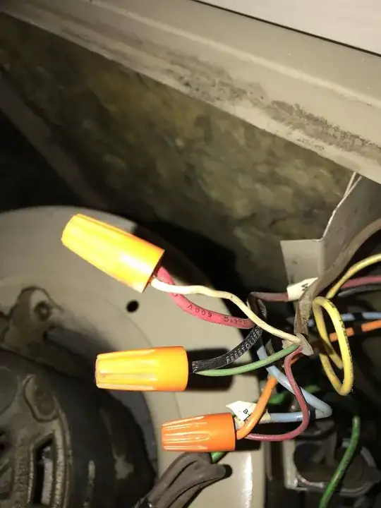

How do I use the green wire as a C wire as suggested in most installation instructions for the newer wi-fi thermostats? They all reference terminal strips at the furnace, all I have is the 3 wire nuts on a older Lennox ES5 series. Thank you.enter image description here

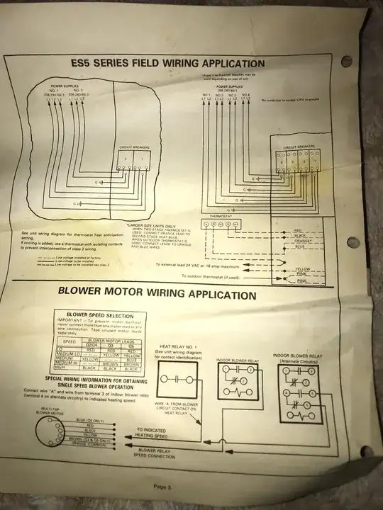

It would appear from the pictures that the blue and orange wires (wire nutted to the red thermostat wire) should go back to the transformer for one of the two 24 volt wires. The other 24 volt wire on the transformer is the common to hook up to the thermostat. There should be 2 other wires that are line voltage coming out of the other end of the transformer. Don’t mess with those. Depending on the transformer there may be multiple taps, without seeing the transformer it would be difficult to tell which ones to use unless the transformer is marked.
