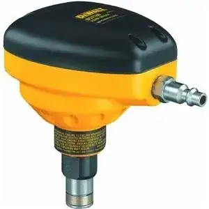

I wouldn't recommend using the palm nailer.... They're not easily controlled and you risk damaging the molding itself.

A palm nailer might work for this.
Palm Nailer Image
