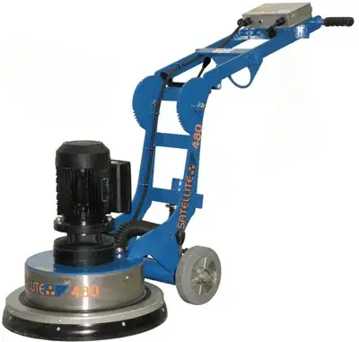

Tool rental places probably rent concrete grinders for big jobs like refinishing concrete floors and then you can use a sander that get get into corners.
Floor Grinder

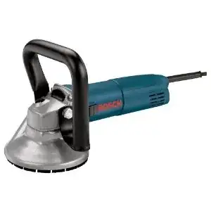

Concrete Sander

You can probably rent one or both of these, depending on the amount of glue. If it's just spotty you can probably use the hand sander.
Like I said, these are for professionally prepare floors for concrete finishing. If it is thin you might try belt sander or palm sander, and buy a sampling of sand papers and see which works best.
