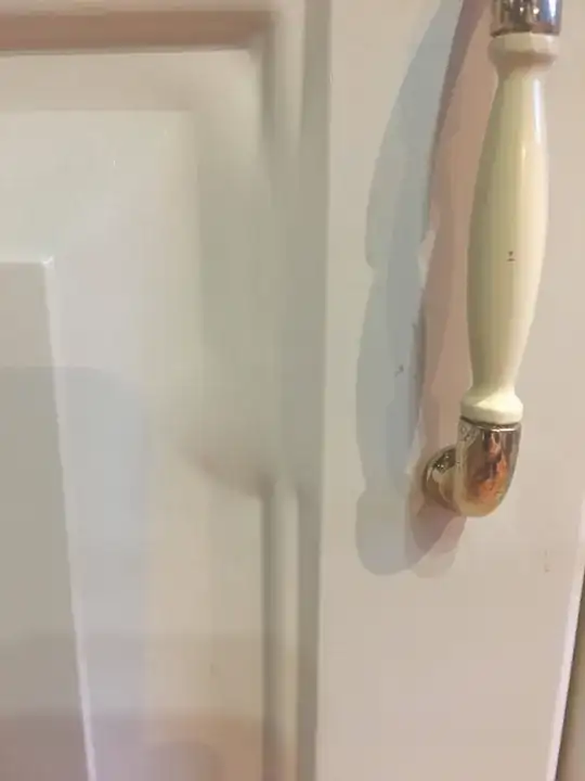

I used the hair dryer to soften the glue then scraped it off. It worked well but then I noticed my laminate cabinets started to bulge where I had heated it up! Something to be wary of if using the hair dryer method.enter image description here

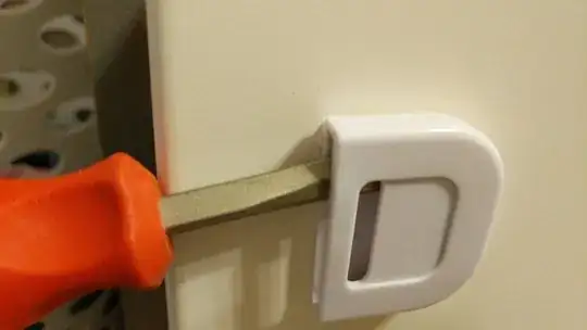

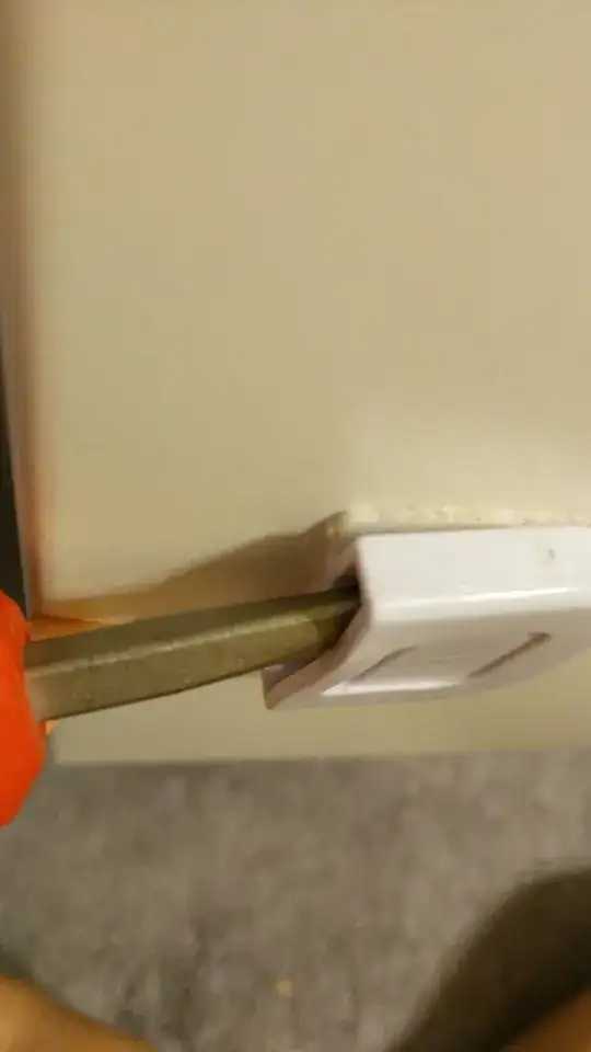

I inserted a flat head screwdriver and gently and slowly pulled forward until it gave way. If you don't tools hard/fast, the plastic clip will snap.
