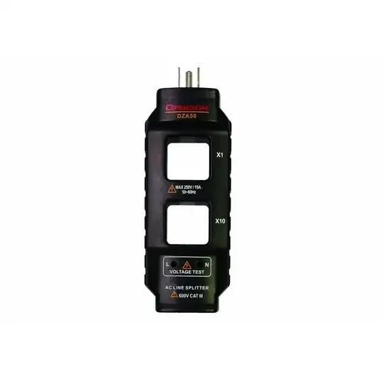

I know you said you didn't want a product, but if someone does, there are devices like this that are made to do just what you want in a safe, listed way. It has one loop for regular measurements and a second loop that multiplies the signal 10x (it just as 10 loops of the wire there).
