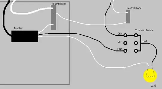

That's to be expected. The neutral from the circuit is going through the GFCI breaker, but the hot is coming from the generator. The GFCI sees this as an imbalance, since there's no current flowing through the hot side of the breaker.
Here's what your setup likely looks like (if it was drawn really quickly in MSPaint).
Bad MSPaint Generator Transfer Switch diagram
If you follow the current through from the generator, you'll see that it returns through the GFCI breaker.

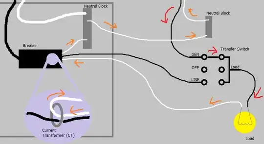

Bad MSPaint Generator Transfer Switch diagram showing current flow
However, since the current is not flowing through the "hot" side of the breaker. The breaker sees an imbalance, and trips.
The cutaway in this image shows the internal circuitry of the GFCI breaker, and depicts the current flowing only on the neutral wire.
Bad MSPaint Generator Transfer Switch diagram showing current flow and CT in breaker

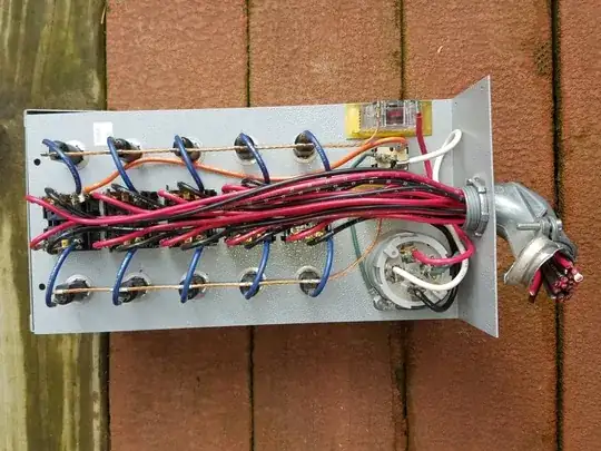

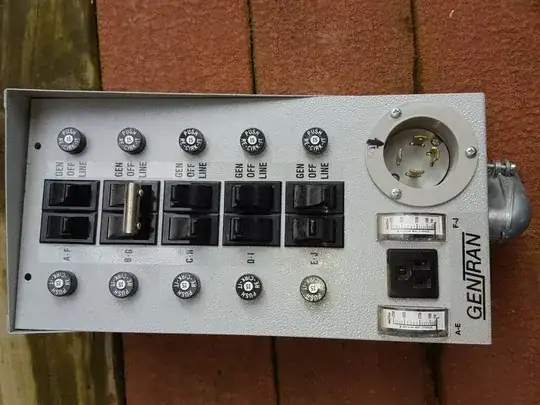

The general concept of these transfer switches is there is a row of SPDT switches. One side taps the generator hot, the other side goes to the panel and taps a circuit's hot off the breaker, and the "common" goes back to the panel and joins the hot wire that used to go to the breaker. There is one single neutral wire that handles all generator current. That's ... ghetto, but workable for a 1960s panel. Here's what it looks like inside.
Look, ma, no neutrals!
