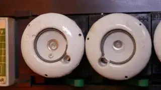

    1. Old fuses
      fuses
      Fuses. The left one has popped.
      Your fuse box may look like this. If so, look for the one that has popped. The small metal circle in the middle of the fuse will be missing. Sometimes it will be visible, as in this image.
      You will need to unscrew its housing, find one of the same amperage, replace it and screw it back in.

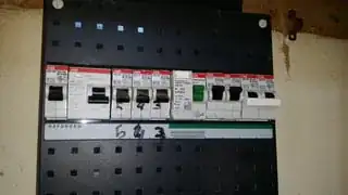

    2. Modern breakers
      breakers
      Breakers. Up is on, down is off.
      If your breakers have a two-part switch, you will see one with a small part of the switch down, while the rest of the switch is still up. If you find more than one switch in this position, keep your hands off because you don't know which one has tripped.
      If they're one part switches, the entire switch will be down. There may be a "trip" position that's different from "off". Again, if you find more than one switch down, don't touch them, since you don't know why they're down.
    Only if you can find the one switch that has tripped, you can switch it back on.
    Now check if the lights are back on. If they're still off, switch that circuit back off.
