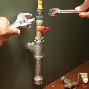

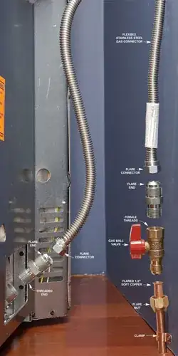

A gas line will usually have a shutoff valve at the end of it. It's usually made of cast iron, steel, flexible steel, or copper.
Here are some pictures of typical stove pipe configurations.
Gas pipe, Steel
Gase pipe, Copper
If it just a metal pipe sticking out of the wall, ask the owner of the house what it is or have a plumber come out and look at it. Don't assume anything.
