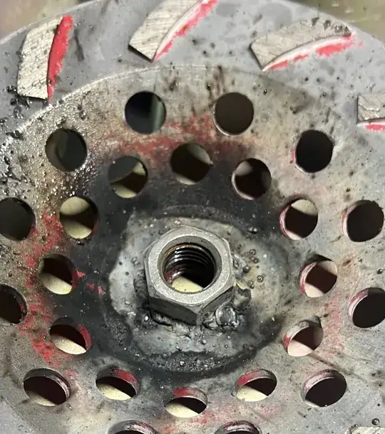

I welded a nut on and then used a socket wrench.
