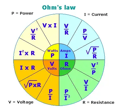

Usually in home applications.. you will(should) never actually have anything even close to that 16A limit. Power leads are typically marked 16A maximum to conform to electrical and home safety standards.
16A X 220Volt = 3500Watts
You will only see devices use more than that in Industrial situations and usually run of multiple phase supplies and massive core cables.
