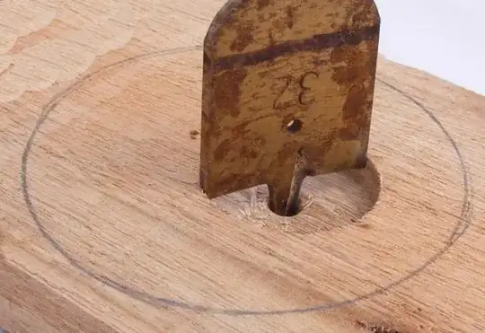

Plastics drill in a similar way to brass, i.e. regular HSS drill bits will pull too quickly into the material, grabbing and possibly snatching. But, for an overflow you're probably going to be drilling a larger hole than regular HSS bits.
I often drill sheet plastic with a sharp flat bit. These drill plastic perfectly as their cutting face is 90 degrees to the material. I agree totally with Mark above, practice a few times because plastic can grab the bit and stop dead, often cracking the workpiece. You want a reasonable speed but not much feed (opposite to the way you drill metal for example). Use a light pressure and if you can have a block of wood at the back, it will help. Be especially careful as the bit gets close to going all the way through, slow down and ease back to a minimal pressure.
Flat or spade drill bit from around 6mm to 32mm
