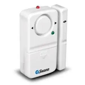

Alarm
You could pick up a magnetic window/door alarm (some more expensive models may also have glass break sensors).
If the window is opened, the alarm will sound.

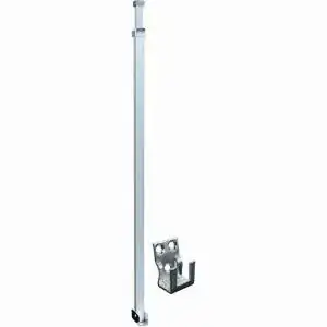

Secure the window
You could purchase, or make a "security bar" similar to the ones used for sliding doors.
This will make it more difficult to open the window, though would not protect against breaking the glass. If you make/purchase an adjustable version, you would even be able to leave the window open slightly and still be protected (as long as it's not open enough for the intruder to slip in).
