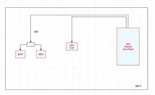

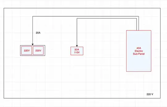

I am in the process of adding subpanel. This question is a continuation from my previous question.
  1. Can I do two 220V receptacles on a single 20A line?
  2. The equipments will be drawing max 3A and 13A. Is it possible to both on a same line?
  3. Can I also use 12/2 cable? or should I use 12/3?
  4. Can these receptacles placed in a double outlet box?
P.S:
Top Image: 2 receptacles separated by a junction box and separately placed
Bottom Image: 2 receptacles in a same double housing
Yes, you can.
Yes, even if they are continuous loads 16 amps would be allowed.
12/2 is all you need
Yes.
You can put as many receptacles as you like on a circuit in residential applications. 240 volt receptacles only require 2 wires and a ground wire. Hence the 12/2 wire is sufficient. Circuits are required to be sized for the load they serve. Continuous loads are required to be sized at 125% of the load served. Devices can be placed in the same box without dividers unless the voltage exceeds 300 volts between devices. Which does not happen in residential applications (here in the US anyway).
Good luck!
