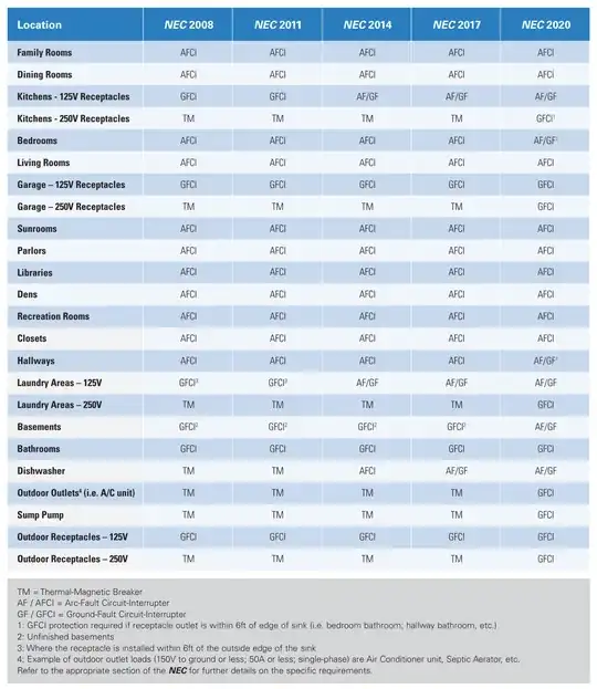

Eaton publishes a very clear summary table for the requirements under 2008 through 2020 code cycles. I'm reproducing it here since this appears to be a popular reference question.
Table of location requirements
