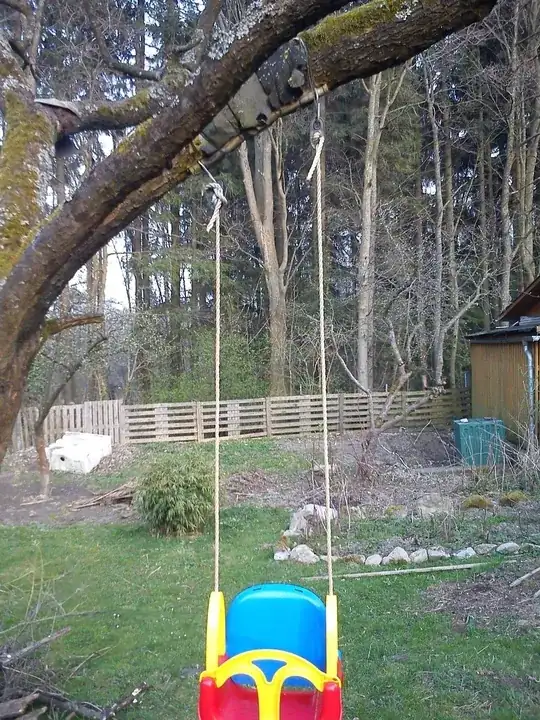

I have bought a swing for my child and she loves it but the problem is that it does not swing straight. It is attached to a branch on a tree and as you can see in the photo below, the branch is not straight and, therefore, the ropes connecting either side of the swing are different lengths. Sadly I have no other tree to attach it to.
Try as I might I cannot get a good swing action on it (the seat turns during the swing even if I am very careful and apply an equal pressure push). I have got a spirit level out and the seat is horizontal (as far as the accuracy of that is able to ascertain) but it swings all wonky. I don't know, I have been tightening and re-tieing knots for months now and my wife is getting angry and the child starts to look at me with a concerned experssion every time I sit her on it to "give it one last go."
Is there a technique for fixing this thing? Should I build some sort of triangular wooden structure under it so the ropes are the same length?

A triangular wooden structure as you describe should work if the ropes are the same length and the hooks the ropes are attached to are both hung vertically. Pendulum period depends on rope length, so the set up you currently have couples pendulums having two different periods. That's a recipe for unstable swinging. Also, the angle pictured on the left attachment point will cause wobbling even if you correct the length problem. That's because it causes one rope to oscillate on a different axis* than the other.
For maximal directional stability in swinging, you want the ropes attachment points to the limb to be set a few inches wider than their attachment pints to the seat of the swing
*Actually given the hookup, a different set of axes, but that overcomplicates things. Just work to preserve symmetry between the two ropes and all will be well.

Replace your standard swing with a tire swing with just one connection to the tree. The tire swing does not have to follow the same path when pushed.
Otherwise, I think you will need to build some sort of level and straight beam using the tree as one anchor and maybe an A frame for the other side with the beam running level and straight between the two.

Try moving the anchor points on the limb closer together - this should give you a more even swinging motion, but might make it more liable to twist. Otherwise you'll probably need to build something.

The anchor points on the branch should be wider than the swing. So spread them out more. Also, remember that rope stretches when weight is applied, so although the seat looks horizontal in the photo, with someone sitting on it, the longer rope will end up slightly lower. Probably only need to shorten by a cm to compensate for this. The key thing will be widening the top connection.

Get a t-bracket that will extend down from the tree to hook / Attach your rope to so there the same length and widen the gap do its slightly wider than the seat.
