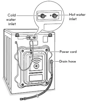

A washing machine should have
  • One detachable flexible cold water feed of indeterminate length.
  • One detachable flexible hot water feed of indeterminate length.
  • One possibly detachable flexible drain line of indeterminate length.
  • One permanently attached electrical cord of indeterminate length.
Back side of washing machine
So the problem you have now is figuring out how long each of these are,and how to disconnect them. It sounds like you don't have much access to the back of the machine to get a good look, so a mirror attached to a telescoping handle might come in handy here.

A washer typically has three connections:
  • Hot Water Line
  • Cold Water Line
  • Water discharge Line
The hot and cold water lines are definately attached to the machine, much like a garden hose is attached to a spigot. The water discharge line may or may not be permanately attached. Ours slides into a drain pipe.
Either way you will need access to the back. Hopefully they left enough slack in the hoses so it can be pulled out.
But in any event, shut off the water leading to those lines, bail out the washer with buckets and towels. If it doesn't seem like it is moving forward, call a plumber rather than making the situation worse.
The danger here is breaking something (pipe or hose) and then you will have a whole mess of water all over the place.

Generally they are connected to the water supply with flexible hoses, as well as the power cable. There should be water shut off valves where the hoses connect to the wall - shut the water off there first. Then disconnect the water hoses and the power cord. At this point you should be able to scoot the machine forward.
This is based on a typical US washer - if you're not in the US the hookup may be different.
