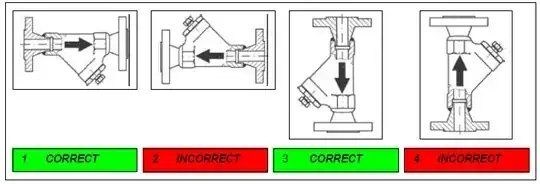

After much research, it appears that manufacturers differ in their recommendations.
For instance, Valvida specifically says “ Y “ – strainers should never be installed in vertical pipelines in the upward flow condition:
Valveda Installation Diagram

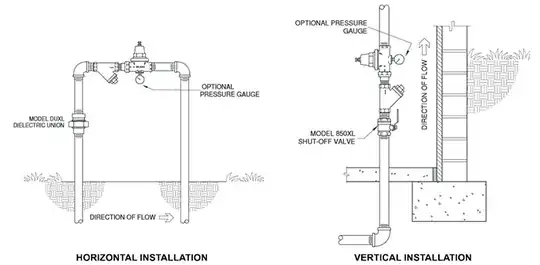

While Wilkins seems to claim that their valves function correctly while installed in an upward flow condition:
Wilkins upward flow installation
