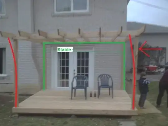

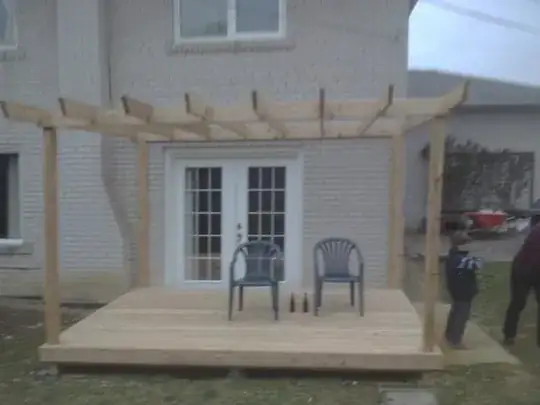

The deck is nearly finished but I have a small structural problem with the pergola. A left or right force near the top of the pergola (such a a tall person leaning on the post) leads to a bit of noticeable wobble. Everything is rock solid at the deck level, and there is no wobble in the in/out direction. The span is 12' from post to post. The beam is 2x6 cedar, with 2" x 2" notches where the pergola joists connect with a six inch screw coming in from the top.
I'm thinking up putting 2x6 cedar diagonals at the posts to the beam, connecting at the first pergola joist on each side (20" from post) at a 45 degree angle. Does this sound like the right thing to do? Is 20" enough? The next joist would be at 40" from the post, and would come down too low.
[Newly Completed pergola(https://i.sstatic.net/rstJD.jpg)
This is an exaggerated view of the flex. Flexing

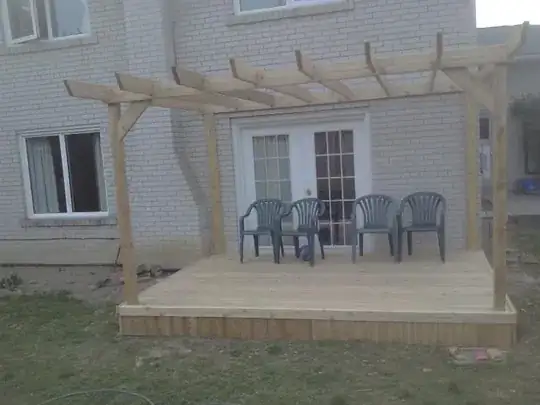

RESOLUTION: I've added one 2x6 45 degree brace in the upper right corner. It stabilized it significantly. I'll put up the other side when time allows.
FINISHED: Rock Solid now. enter image description here

The pergola is much like a stick framed house--the framing itself resists vertical forces (gravity) but in and of itself, has no resistance to shear forces (side to side). For a house to stand up on its own, the sides need to be braced against shear forces...typically that's done with plywood sheathing. Barring that, diagonal bracing can be used.
On the pergola, since it's attached to the house, the house is acting as shear resistance on 3 sides of your pergola, but the front is the weak spot, as you've found out.
Some potential options:
  • sink the front two posts into the ground several feet and surround with concrete (typically you'd want 1/3 of the post in the ground
  • add diagonal bracing. 45 degrees is the strongest but for the pergola, likely not a requirement. If 45 degrees brings the braces too low, you could consider a different angle. Or make it an architectural detail...perhaps bringing the braces on the outside of the posts (extending the top beam)
  • metal reinforcement. Pick up some metal L-plates. The bigger the better and attach them to the post and beam.
  • add a railing to that side of the deck and diagonal brace that (tensioned cables, wood panels, diagonal rails, etc.)
  • add tensioned metal cables diagonally between the tops of the two posts. Not sure you could enough of an angle to make that work or not, though.
  • add diagonal bracing to the TOP of the trellis. Create a giant 'x' using wood beams or, again, possibly tensioned cables. That will transfer the horizontal shear forces on the front back to the ledger and house.
You will have to do something, though. Even a 'wiggle' of a couple of inches will cause problems over time as the wind rocks it back and forth. The hardware may not fail but eventually the wood where the hardware connects the members will fail with wear over time.
Of the options I listed, I'd probably start by getting some large L plates. It's likely the least expensive option and you can hide them fairly easy on the inside of the posts and beams. Alternatively, you might be able to use some heavy duty metal shelf brackets. As a bonus, you might find some with some architectural detail that will look nice.

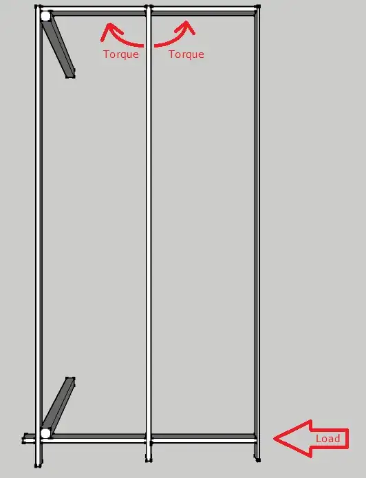

I'm not sure how the cross beams are attached to the support beam near the house, but it seems to me that would be the point you need to focus on. Any small amount of flex in the outer most posts can be translated into movement, because the cross beams are able to torque at the ends.

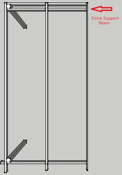

You may be able to eliminate this torquing, by adding in an additional support beam near the house. Like this.
Top View of Pergola
Due to the length of the cross beams, this may not eliminate all of the movement. Any flexibility in the cross beams span could still translate into movement at the outer posts, but it should be much less than you are seeing now.
In most pergola construction, support beams are doubled up at the posts to limit torquing. Tight fitting joints will also eliminate some movement. If you don't need a mallet to fit the joints, your notches are too loose.
