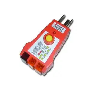

An outlet tester, and a more thorough inspection of the wiring, can tell you. Head to Home Depot, Lowe's, Ace, whatever, and pick up a 3-prong GFCI outlet tester:
Plug it into all of the outlets on each receptacle; ideally, you should see the two amber lamps light, but that's unlikely if the surge protector doesn't detect a proper ground path. What's more likely is that you'll see only the middle lamp light, indicating an "open ground".
Unfortunately, because the neutral and ground are supposed to be continuous (they both tie directly to the neutral bus strip in the service panel), there isn't a really good way to detect a neutral-to-ground short or swap without opening up all the outlet boxes; a 3-lamp tester will read "correct", and a multimeter will read continuity between neutral and ground no matter whether they're correct, swapped or shorted. However, this scenario is very unlikely in your case, as the surge protector should read "grounded" if the ground pin has continuity.

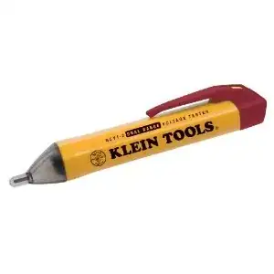

If that doesn't indicate the cause of the problem, you will need to determine which of the various wire bundles is fed directly fro the panel. This is generally done by disconnecting all the black wires from all the outlets, then turning the power back on and VERY CAREFULLY probing each one with a non-contact voltage tester, like this:
The black wire that lights up is the one fed most directly from the panel; however, it may not be the actual wire run from the panel itself, as there could be something further "upstream". The usual culprit is the switch for the lights, especially in older homes (newer NEC code encourages lights and outlets to be on different circuits, by encouraging calculation of demand load based on separate lighting and appliance branch components, so you're not fumbling around in the dark if your hair dryer shorts out). If your NCVT lights up on anything else that you know is "dead" when the power to this circuit is off, turn the circuit back off and pull those things out of their boxes to inspect those wires. Check for the existence of ground wires, whether they're properly continuous with all other grounds, and with all black wires disconnected, whether any black wire still lights up with the power on.
