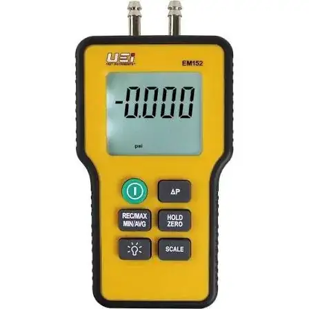

I'm leaning towards number two as the most likely culprit. You may need a tech to check these things out. Unless you have a manometer.
Digital Manometer
Amazon
You can make one easily but it's a pain to use.
Homemade Manometer
Flickr
You literally measure the difference in inches with one side connected to the gas valve at the inlet pressure port or outlet pressure port.
