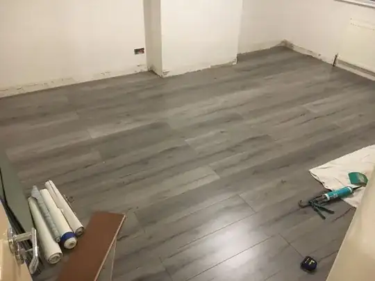

I've been redoing my room (walls and floor) but now I am stuck on the skirting boards. Here is the room at the moment
The room
The walls are uneven and also I wanted to put the laminate floor under the skirting boards so it looks neater. However, I am told that skirting boards are usually fit with glue and nails and that means if I have to replace the floor or some part of the floor (if damaged), it will be a big mess taking out the skirting boards.
So the question is, is it even recommended to fit them using screws directly into the walls (they are brickwork with a big layer of plaster/filler? not plasterboard).
The house is early 1900s i believe (Morden, London, UK)
Thanks

UPDATED:
I misread about the masonry walls. I've actually installed base trim using trim screws and plastic plug anchors. It works fine, but the holes in the trim are larger.
ORIGINAL:
Glue is only used for joints, and nails pull out of the wall fairly easily when the boards are removed. They can then be pulled through the boards from the back side so the boards can be reused.
You can certainly use screws, but the holes will be much larger and therefore more difficult to conceal.
In general, trim isn't installed with the expectation that it'll be regularly removed.
