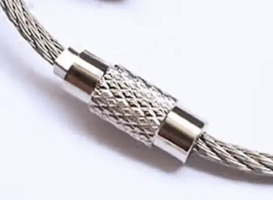

First, I would like to what is the best tools to cut a Stainless Steel cable? Second, I would like to know how to install this kind of lock in the stainless stell cable? Thanks.enter image description here

Good wire cutters. I have also used a chisel and anvil. Then you need the correct size of crimp or swage fitting. Depending on the size , there are also regular cable clamps. Carbon steel or stainless steel are similar high strength so that makes no difference to the cutting. I have assumed a small size like 1/8 in.
