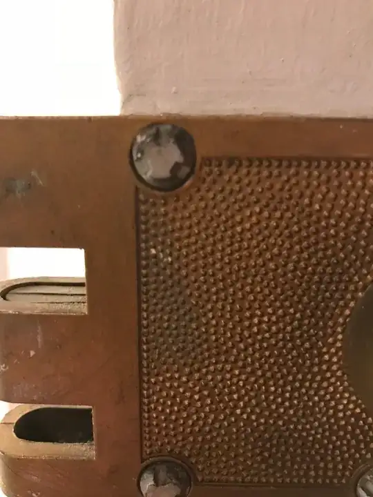

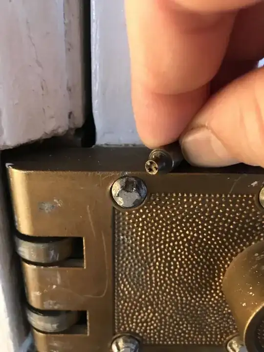

Anyone know what bit would fit this? I have only seen the 2-prong spanner bits...

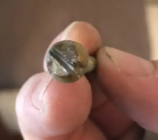

Here's what I eventually did to get the screws out:
  • Used a Dremel rotary tool with a metal cutting wheel on it
  • Cut slots across the head of each screw
  • Used a flathead screwdriver to remove them
Hope that helps anyone who might come across this issue in the future.

These are indeed very rare. And old. Google image search kept showing old radio sets.
After a lengthy search I found one source that should do the trick for you.
Microtech Medium Domed Tri-Wing Wrench Tool Bit (bladehq.com)

These are tri-groove screws. Tri-groove drivers and sockets are available from McMaster Carr, among other places. The ones pictured above are probably #10.
