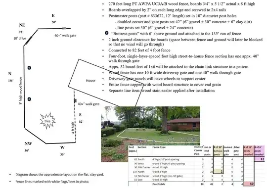

I hope to have someone else install an 8 foot high PT wood fence. There will be no light or air passing through or under the fence and it will be heavier than average, given the additional height and board weight. One side will run for 135’. The attached diagram provides more detail.
The PostMaster Installation Instructions describe a 30” deep, sloped, 10” diameter hole, filled with 6” of gravel plus 24” of concrete for a 6 foot high fence. They caveat that the “exact diameter and depth will be determined by local weather and soil conditions.” Got it. Huntsville, AL; very clay soil. Maximum wind gusts of 65 mph. (This is not in the normal tornado path and is not intended to withstand a tornado.)
In reviewing the StackExchange posts on fencing and post holes I came across the concept that the diameter of the pier may be increased to compensate for a shallower post hole. enter image description here I would like to know the recommended depth and diameter without relying on the 2 buttress posts, which are my small overbuild idea. We will be able to walk under them.

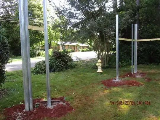

Posts were installed this week in 9" diameter holes, with a minimum depth of 30". They were pounded a bit into the clay before 30" of concrete was 'poured' into each one, with a few inches of clay on top. They flex, so should handle any wind loads with ease.
